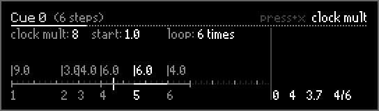

In the cue editor a single cue is shown with the timeline of a cue from left to right. Along the timeline the cue steps are shown with the step number below the timeline and the length of the of the step above the timeline. Dark gray ticks highlight the main clock beats with brighter ticks every 4 and 16 beats.
To the right you can see the current cue progress with from left to right: the current cue, the current step, the time until the next step is reached and finally the number times the cue has looped. If cues are triggered from other cues with startCue() multiple rows of cue progress is shown.

    • step length sets the length of the current step. By changing the step length all steps that follow the current are also moved on the timeline. If shift is held however the currently selected step can be moved on the timeline without moving the other steps.
    • clock mult sets resolution of the cue’s timeline.
    • start sets the cue starting quantization when triggered using cue+#. If set to 4 for example, when the cue is selected by pressing cue+# it will wait with starting until the beginning of the next 4 beats (in relation to the main clock reset).
    • loop sets how many times a cue loops.

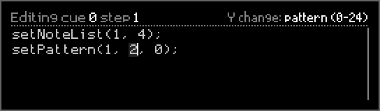

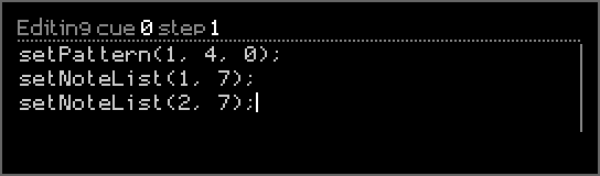

../_images/cue-code-example-1.png
In the code above the pattern of track 1 is set to 4 and then the note list on track 1 and 2 is set to 7.

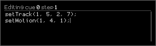

In the code above on track 1 the pattern is set to 5, note list to 2 and motion recording to 7. On the next line however it sets the motion recording to 4. Because code executes instantaneously and goes from top to bottom, motion recording 7 will effectively not be selected because directly after that motion recording 4 is selected.
To quickly turn the current selections for pattern, note list and motion recordings of all tracks into code, press edit and select insert current state. This will insert a setTrack() function call for each track with the current values already filled in.

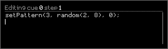

Variation can be introduced in action by means of using random numbers in commands. For example, instead of setting the pattern on track 3 to 2 every time this cue step is executed, we can use the random() function instead:
  • Press pattern+# to insert the setPattern() command.
  • Use X to move the cursor to the second function argument and press no to remove the number.
  • Press edit and select insert code.
  • Select random() and press yes.
  • Use X and Y to adjust the range of random numbers.
The code should now look something like this:
../_images/cue-code-example-random.png
Each time the cue step is executed the random() function will output a new random number.

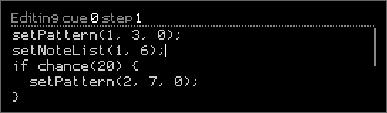

if statements can be used to only execute certain commands if a condition evaluates to true. For example, let’s use an if statement together with the chance() function to only execute a bit of code 20% of the time:
  • Press edit and select insert control flow.
  • Select if statement and press yes.
  • The if statement is now inserted and the cursor placed in the position where the condition is to be placed.
  • Press edit and select insert function.
  • Select chance() and press yes.
  • Use X and Y to set the chance to 20.
  • Add one or more commands on the empty line between the { and }. These will only be executed 20% of the time when this cue step is executed.
../_images/cue-code-example-if.png
In the code above it selects pattern 3 and note list 6 on track 1. Then on the third line we find the if statement with chance(20) as condition. If chance(20) evaluates to true the block of code that starts with { and ends with } is executed. In practice that means that when this code is executed there is a 20% chance that on track 2 the pattern is set to 7.
