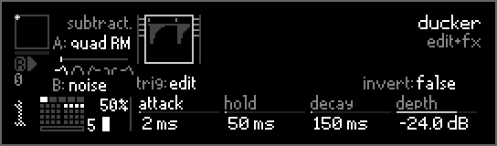

Ducker applies a volume envelope on incoming signal when triggered.
In non-inverted mode when triggered the envelope lowers the volume by the amount set with depth. In this mode Ducker can be used to lower the volume when a note plays on another track similar to side-chain compression.
In inverted mode the volume is attenuated to depth and raised back to normal when the envelope is triggered. In this mode Ducker can be used to apply rhythmical “trance gate” effects.
attack sets the attack time of the envelope.
hold sets the hold time of the envelope.
decay sets the decay time of the envelope.
depth sets how much the volume is attenuated by the envelope.
trig opens the menu for setting trigger sources.

invert switches between lowering the volume when triggered (false) or raising the volume when triggered (true).
