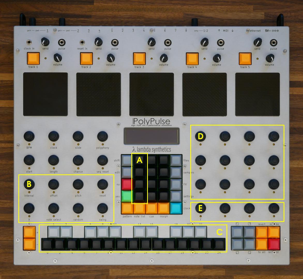

_images/panel-quickstart.jpg
  • Press the corresponding button [A] to enable the pulse.
  • Use encoder X to select a pulse to edit
  • Turn the encoders [B] to change the rhythm and octave of the pulse.
  • Press edit+notelist to open the note list editor:
_images/quickstart-notelist-editor.png
  • Hold no until the note list is empty.
  • Press notes on the keyboard [C] to a melody to the note list.
  • Press yes to exit the note list editor.
  • Turn an encoder on the right side [D] change the sound engines parameters:
_images/quickstart-sound-engine.png
  • Use encoder Y to select one of the envelopes and the three encoders next to it [E] to change the envelope shape.
